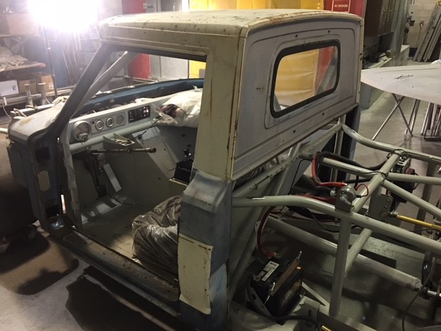

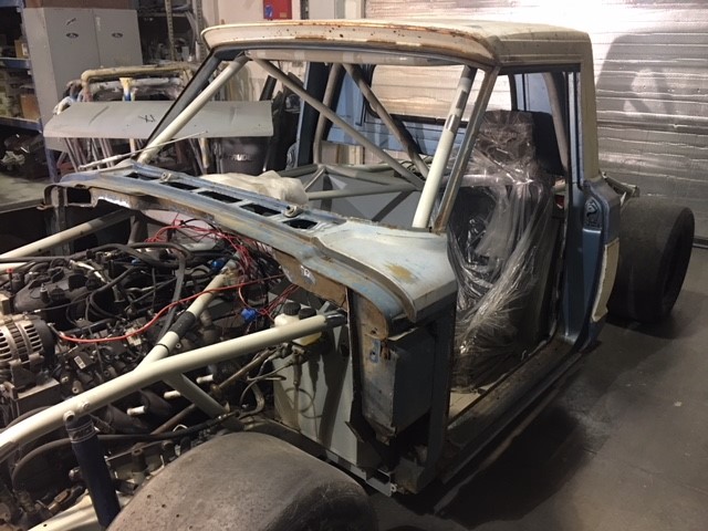

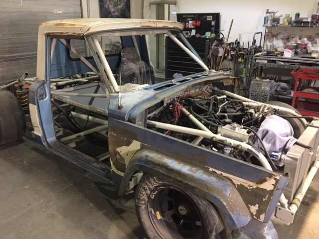

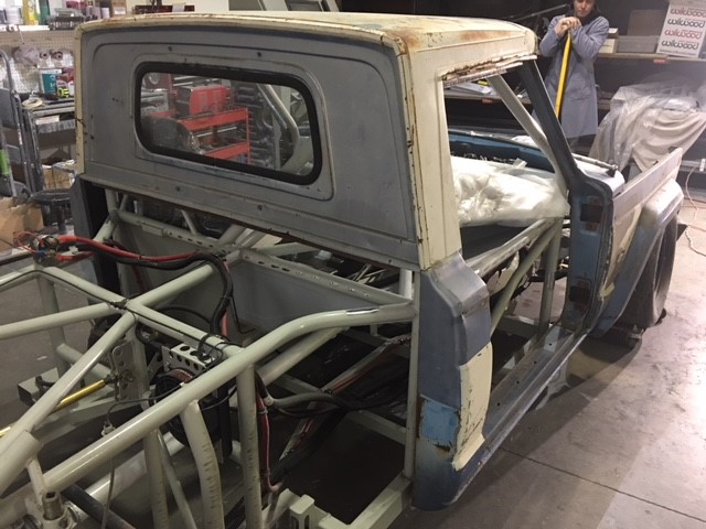

      Picked up a 1964 Willy's J300 truck Cab with a clean title last weekend! The idea is to do a 'skin-graft' of sorts. Will keep the fiberglass s10 panels on the bed, but hoping get the cab and front end to fit.
      Per your recommendation, I checked out Official Pro C10 and a few other places for ideas, but any recommendations are welcomed!

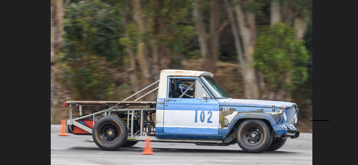

      First few autocross events are in the books! Ran well all day. Doing cam, springs, injectors and regulator next. Was lucky enough to get my hands on some used Pirelli slicks from a local TA2 team.Name:  IMG_5482.jpg

      A few photos from a local road rally last month. I lost the air filter a few miles into the drive, but a motorcyclist picked it up and we zip tied it back on at the first stop. The truck did great.
