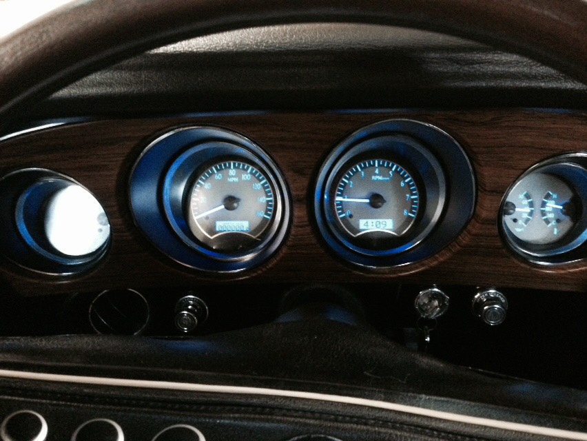

      I have 5.0 Coyote swap in 1969 Mustang. I am using the M - 6017 - A 504 V Ford Racing Control Pack, but the computer does not see the speedometer. The meter is equipped with Dakota Digital but the speedometer is not moving here. I think the transmission is MT 82. How do I put the speedometer VSS in my computer?Name:  IMG_0747 2.jpg

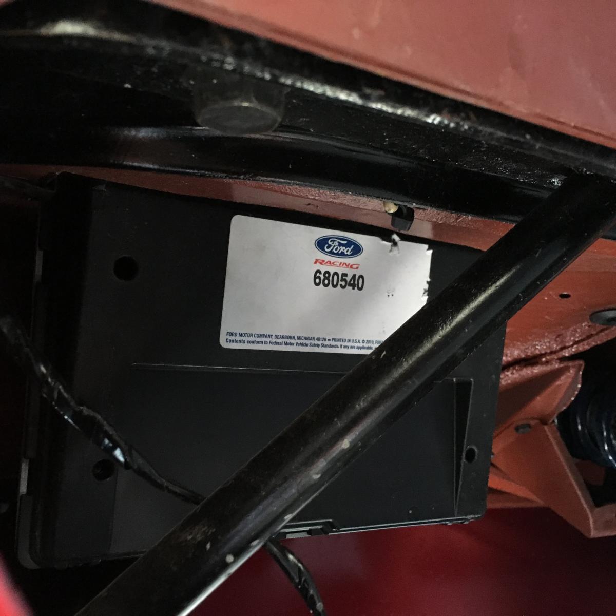

      Vss ecm
Size:  110.2 KBName:  2015-mustang-engine-specs-50l-v8-coyote_7745.jpg
Size:  133.6 KBI am thinking that my engine is 2011. I think that charge motion control valve actuator is not attached. The computer has 680540

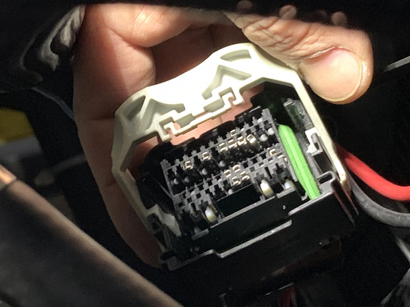

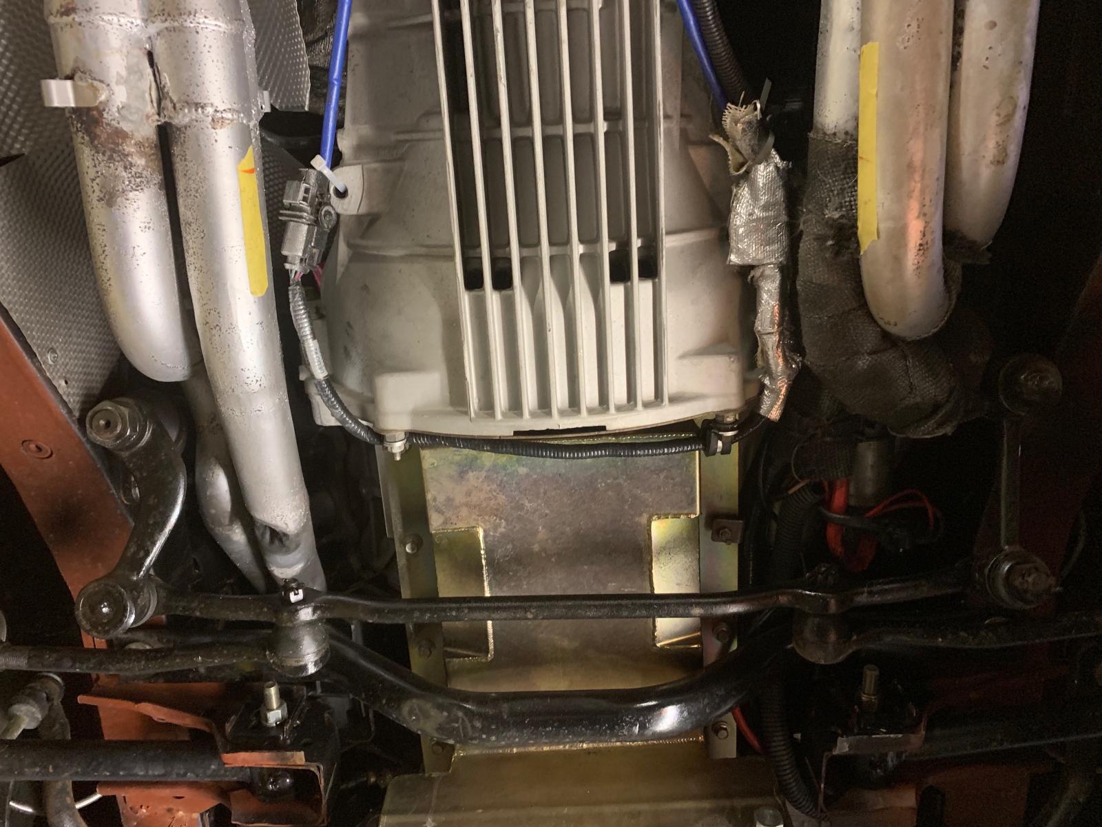

      i think I will enter OSS directly into the control pack.
Size:  201.8 KBName:  IMG_2300.jpg
Size:  121.0 KBName:  IMG_2298.jpg

      Based on the picture of the PCM I believe you have Gen 1 controls pack, so I say yes. As a side note, Dakota Digital's website does not recommend the BIM-01-2 for the controls pack because it provides a limited amount of data.
