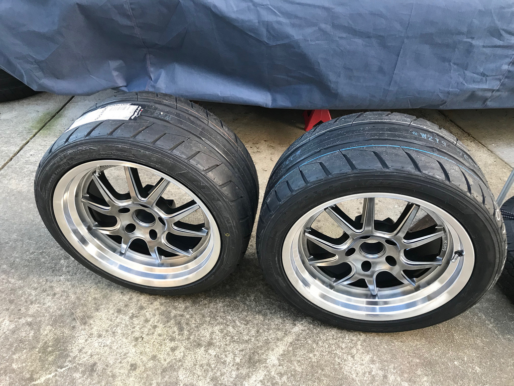

      255-45-17 on 8” and 295-45-17 on 9.5” vintage wheels V40

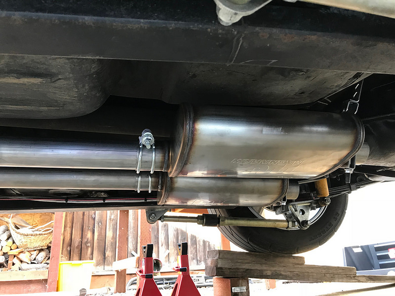

      Got the exhaust system on yesterday. Sounds great - still plenty loud, but more mellow now. Must be quieter because I can hear the fuel pump running with the engine running from outside the car - never noticed that before the exhaust was so loud!
      The fit was good, but I ran into one clearance issue with the straight Pypes collector reducers - the passenger side was too close to the TH350 crossmember - actually touched it. So I ended up using the connector from the front of the old system which was welded together and had a downward angle of 10-20 degrees. That gave enough clearance. I may re-do that when I swap the T56 in depending on where things end up with crossmember location and such. So I'm leaving it all connectors rather than welding it. Seems to be tight and no leaks.
      Clearance is very tight at the trans crossmember, maybe .25-.33" at most. Clearance to body is 1/2" on pass side and more on the other. The system is a bit tweaked to the pass side due to the crossmember clearance issue. Hopefully the T56 crossmember will be better not worse there!

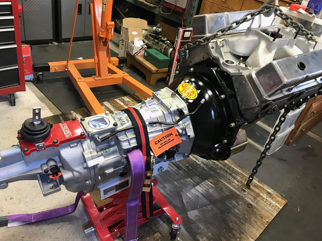

      Last one is the real reason I pulled the motor. New Tremec T56 Magnum close ratio is ready to install in place of the TH350.

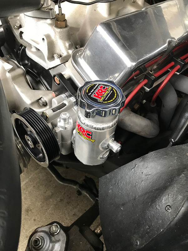

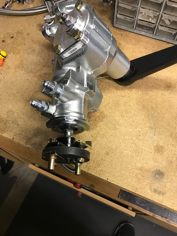

      Also upgraded to power steering from manual steering. Went with a PSC pro-touring 700 series box with 12.7:1 ratio. Feel is really good - very nice weighting and very precise and responsive. Used a KRC racing pump and associated drive set-up.

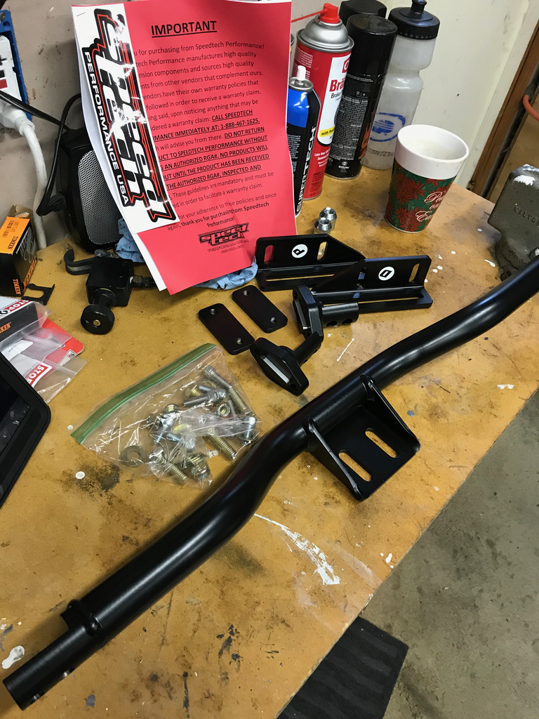

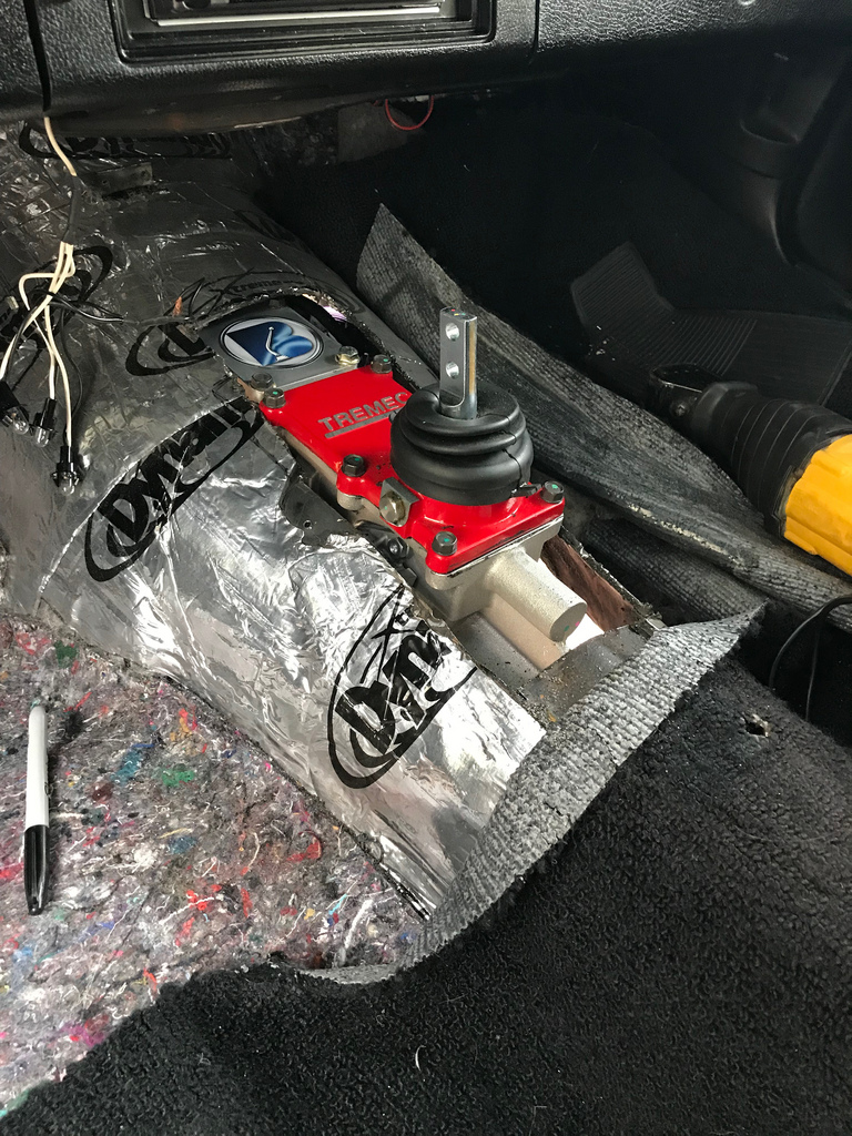

      And finally a few shots of the T56 install. Using SpeedTech trans mount and tunnel cover. So far only did rough mock-up to clearance tunnel.
      Working on aligning bellhousing. using Centerforce DF clutch and Tilton 6000 series TO bearing and a RAM 25lb billet steel flywheel.

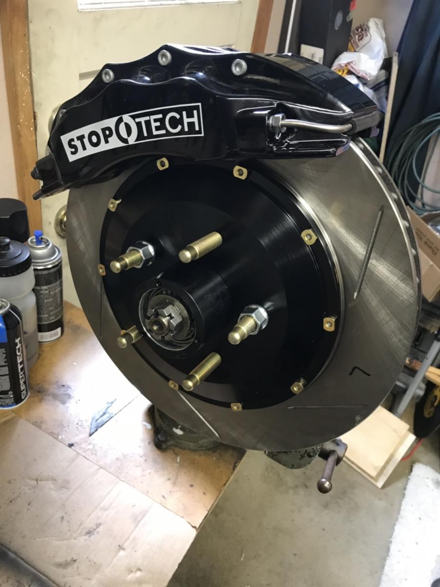

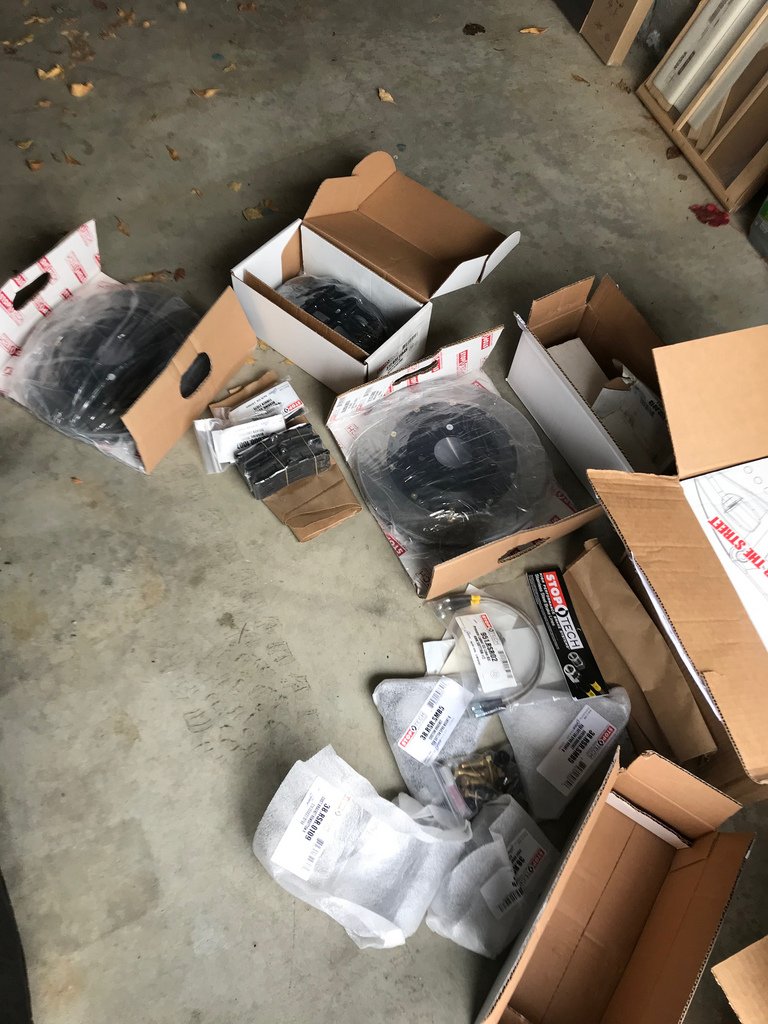

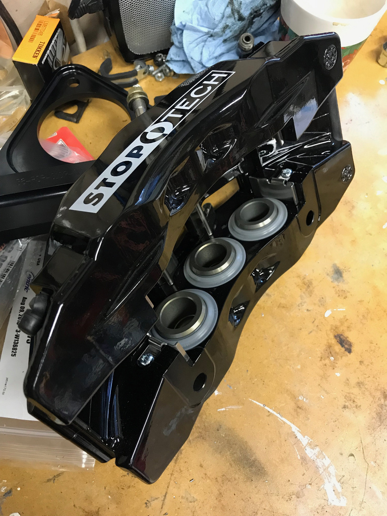

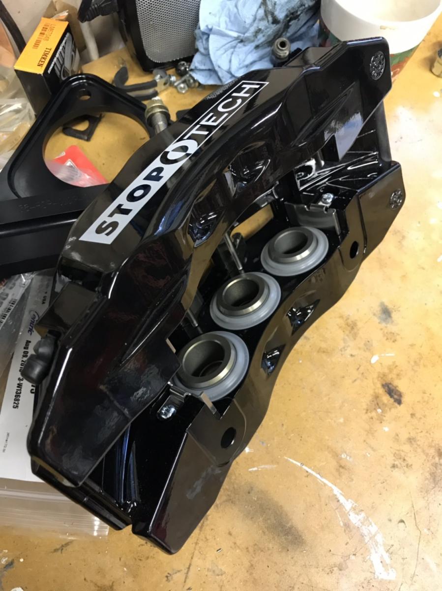

      Brakes coming along. StopTech new kit design by Ron Sutton for stock GM tall spindles. 14” rotors and ST60 calipers.

      Are those brake kits still available?
      Interested to see how they fit and work, does look like a nice set up.
      Oct 2018
      San Jose, CA
      523
      This is a new kit that will be offered - my car is a tester for it.
      It’s really nice stuff.

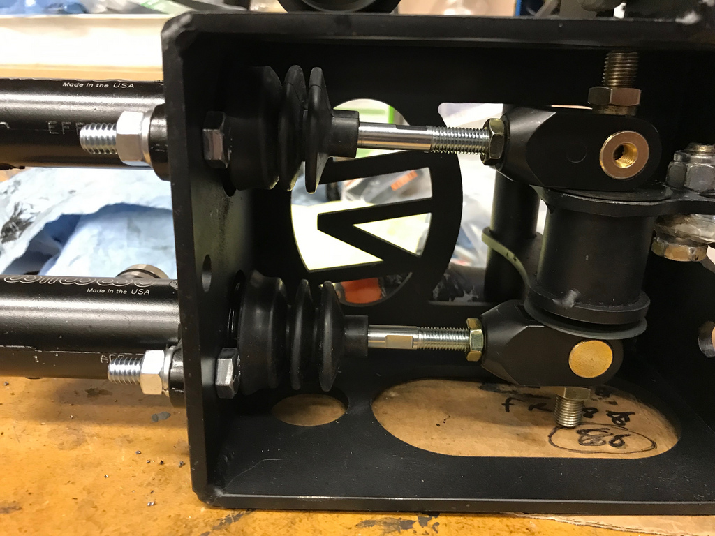

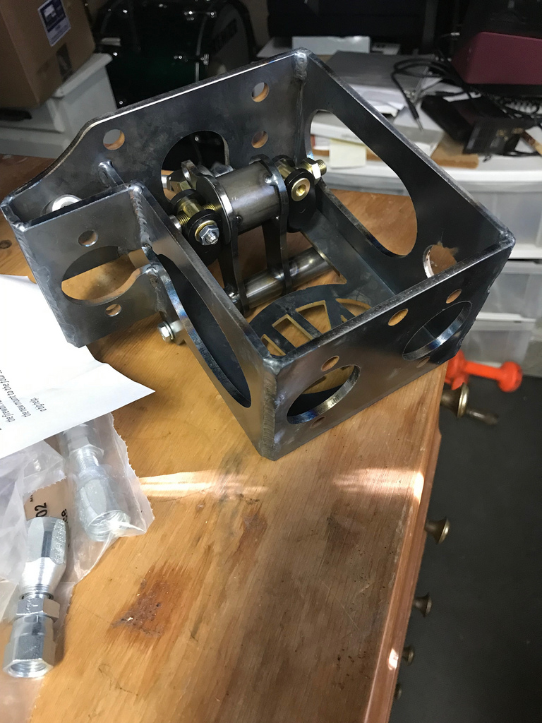

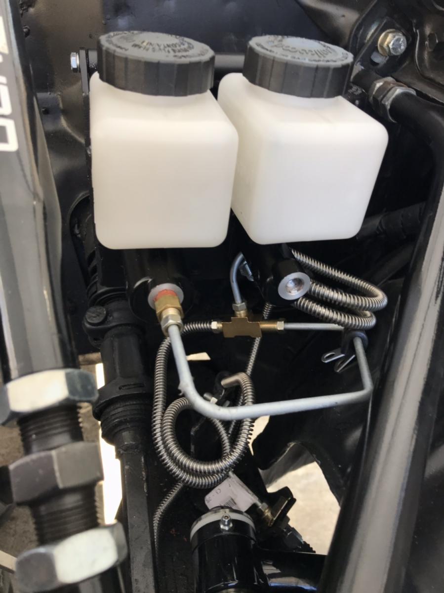

      brake bracket from No Limits Engineering in TN assembled and installed for mock-up.
      This is set-up for stock pedals and uses a Wildwood balance bar for the brakes with dual masters.
      The threaded rod they sent is not long enough - this was designed for a 1st gen although they supposedly have installed in a few 2nd gens before. Also the clutch master hole is right where the stock fuse box is - so I had to relocate that 1.5" lower.
      Now it all clears and there is just one small wiring loom I need to slightly relocate in the cabin and I should be all set.
      It's a pretty nifty design - but far from a bolt in. Not that I expected it to be.

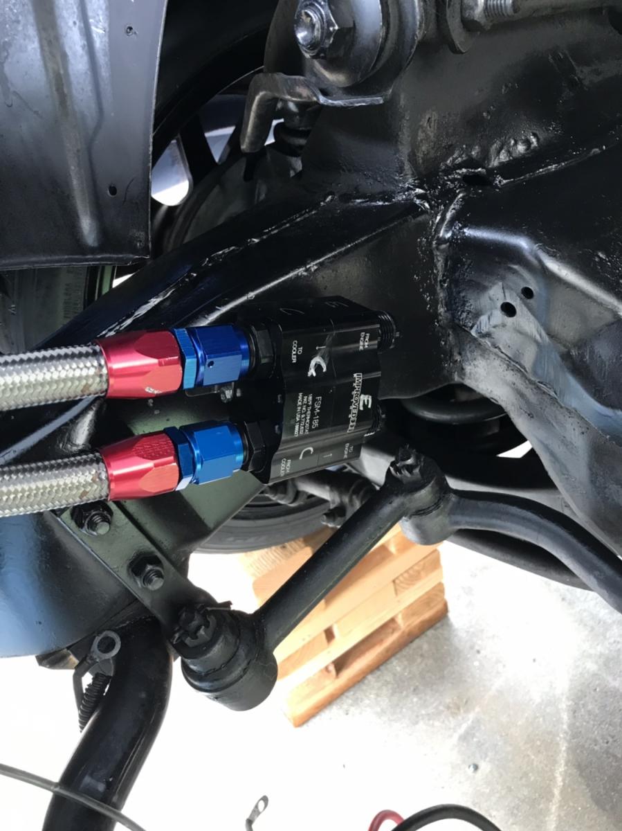

      Working on oil cooler w 185 thermostat. Realized my headers don’t clear the side exit adapter. Ordered one with outputs I can adjust towards front. Also learned you cannot block off these adapters. Blocks off oil flow into top end of motor.
      Good to know!

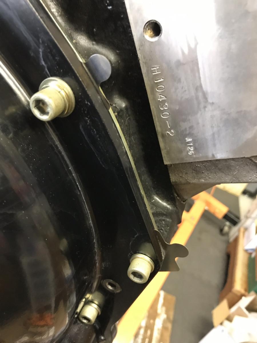

      Also got bellhousing aligned within .008 concentric and .001-.002 parallel on both axis.

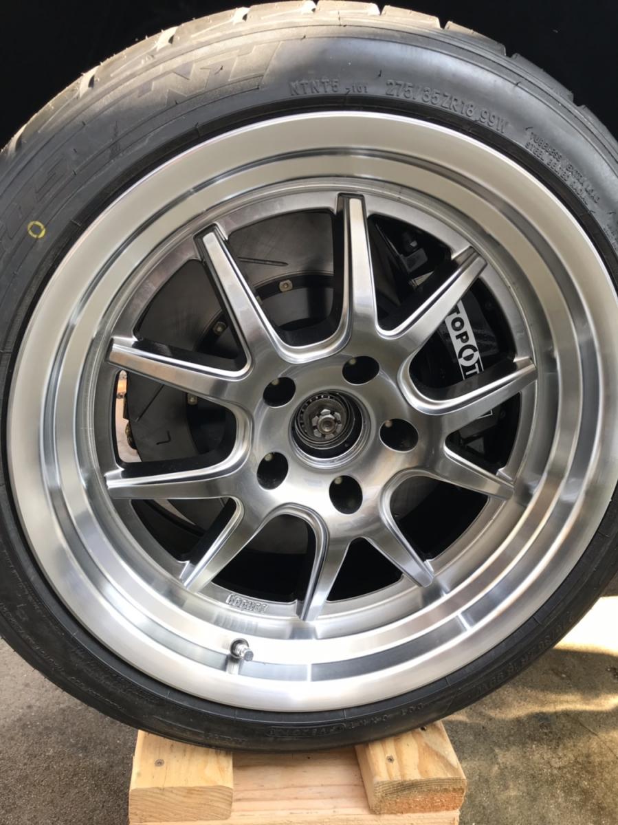

      Got brakes final assembly done both sides along with new DSE UCA and bilstien shocks. Also mounted and did half the plumbing for oil cooler and 185 deg thermostat.
