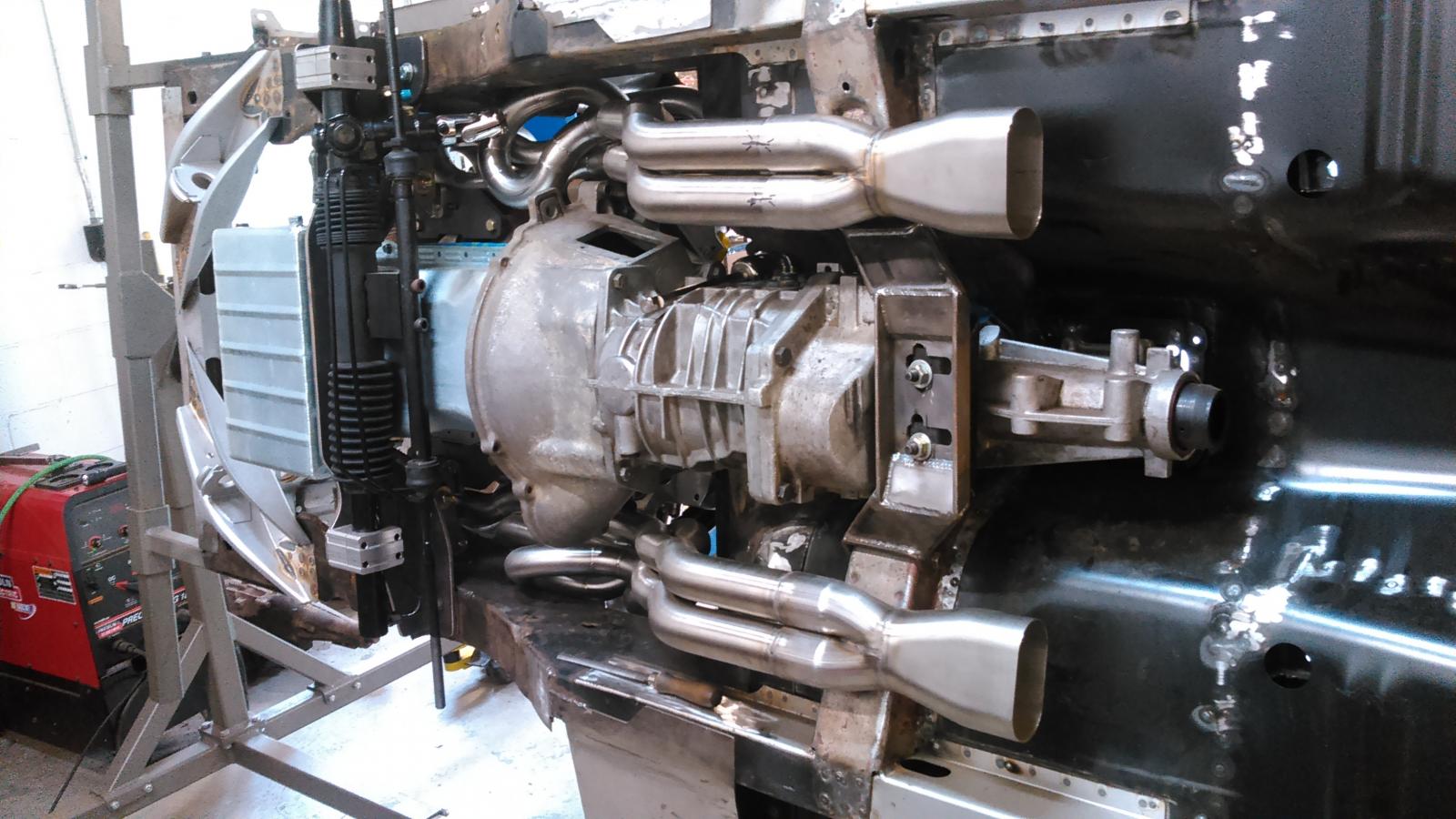

      Apr 2012
      NC
      165
      Build some yourself with oval collectors, lots of ground clearance.
