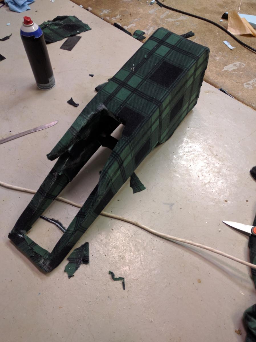

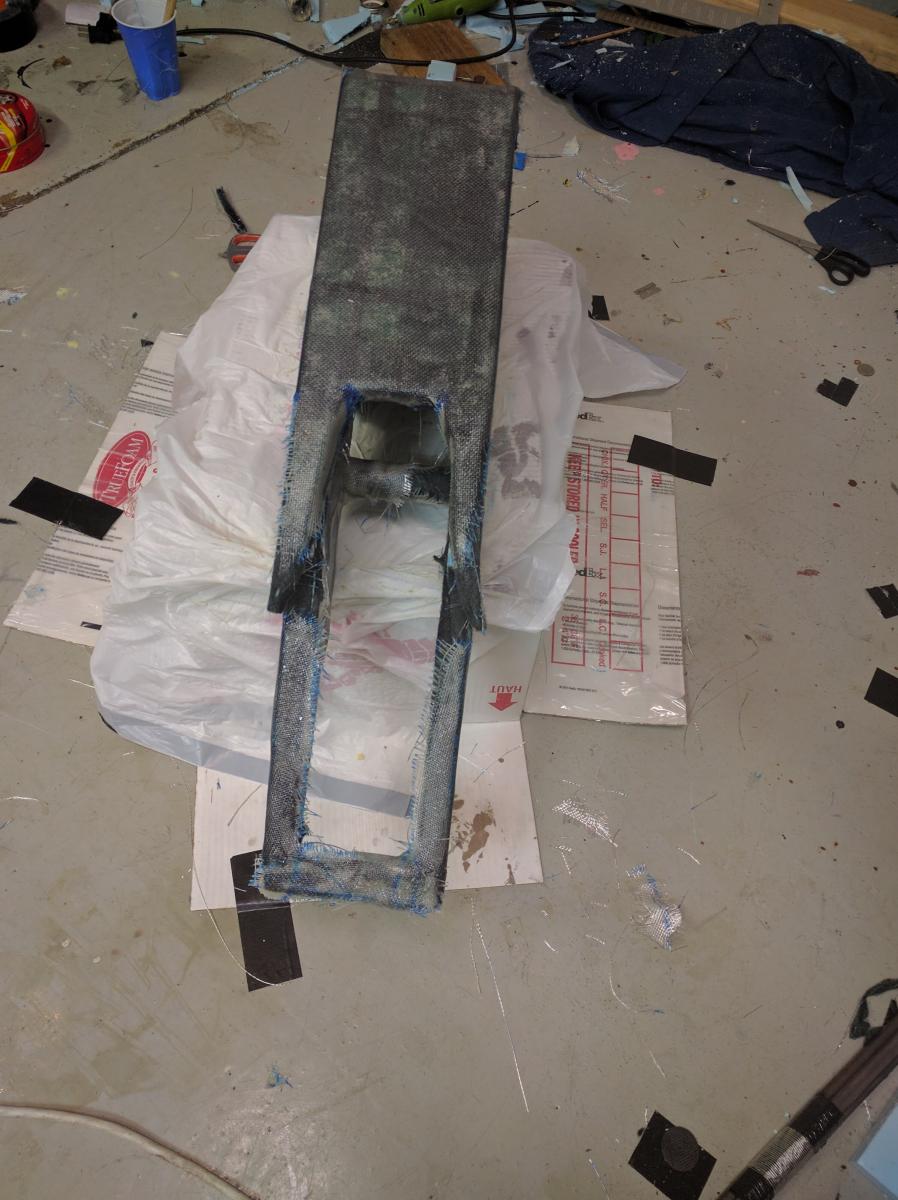

      Then, watching “SprayWays customs” on youtube I got the jist of fiberglassing. I went with West System 105 epoxy resin, mostly because it doesn’t reek like bondo type fiberglass, it’s pricier but has really convenient pumps for mixing. I went with the 205 “FAST” hardener, and-yeah, it’s fast. Too fast for a newb like me to wet everything out so my next buy was the “slow” 206 hardener which gave me a lot more working time.

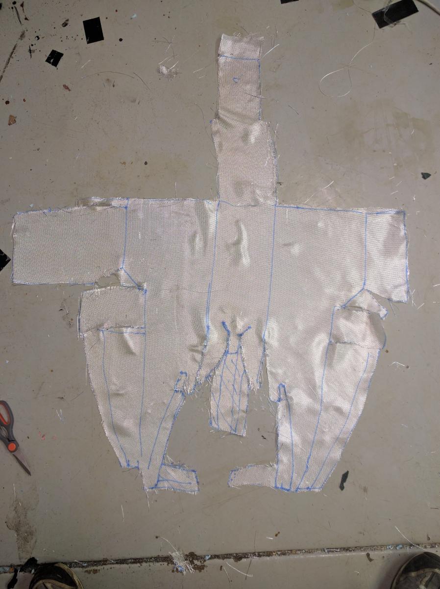

      For the first prototype I used some really cheap fleece from the fabric store. I tried to trace it out and cut it from a single piece. Not sure why I did that-it worked to give a pretty smooth surface without a lot of overlapping fibers, but not sure if it’s necessary.
Size:  124.7 KBName:  proto1_Fleece.jpg
Size:  112.0 KBName:  proto1_dried.jpg
Size:  118.2 KBName:  proto1_FGWeeve.jpg
Size:  131.6 KBName:  Proto1_tracedFG.jpg

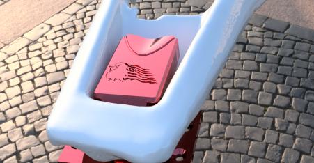

      ,and the second will actuate the exhaust cutouts. My exhaust cutouts already have a long throw switch that is wired nicely, so I wanted to keep that. So I decided to design a switch that would fit in the bezel and actuate the existing switch. Fusion360 makes this real easy as I already had a 3D model and you can design in the same work space.
      I designed probly 4 different switches until I found one that looked right. I also made a basic model of the current switch, and was able to ensure that the new switch would rotate enough to activate the current one, as well as have enough space to fit my finger underneath it, all while not interfering with the bezel.
      If anyone is interested, I can take a quick video showing how the switch moves in Fusion.
      I showed the concept to my old navy buddy and he commented how 'merica that switch was and I totally agreed, so it is now henceforth my " 'Merica cutout switch"! Coincidental a few weeks later, my little 6 year old girl was learning how to draw bald eagles and flags and frogs and other stuff from a youtube channel and she was really good at them. So I asked her to draw me a bald eagle and a flag. I took those drawings and you can just insert them into the background of the CAD, and create actual geometry from them just by tracing the pics.
      Name:  bald eagle drawing.jpg
      This might be my favorite part of the car now since my little girl designed it for me! Once it was all finished up, Fusion will export the file to be 3D printed. I just uploaded to Shapeways.com, paid $22 and waited a week and then the switch was at my door. While I waited, I played around with the rendering tool in Fusion and captured some shots(it was ridiculously easy-took me about 20 minutes start to finish).Name:  renderedSwitchClose.jpg

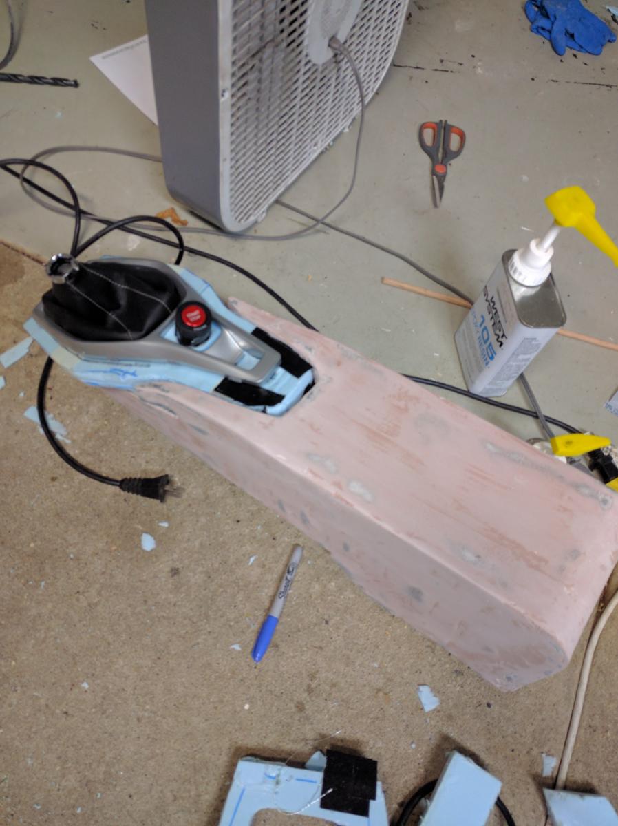

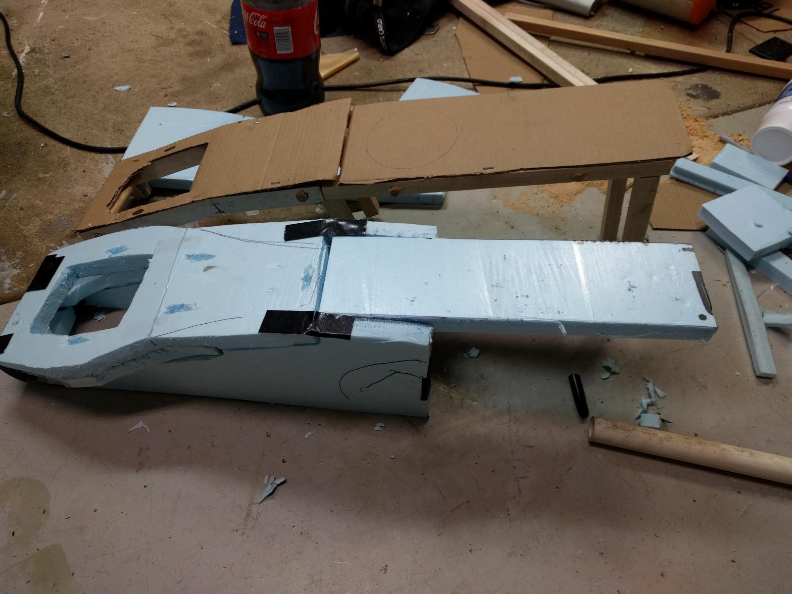

      The console prior to fiberglassing looks like this:
Size:  213.8 KBName:  proto2_foam.jpg
      And functionally, not anything close to complete, looks like this:
      I'm real interested in what you think, likes/dislikes, directions whatever, I'm planning on starting the 3rd prototype in late august before it starts to get cold and makes fiberglassing more difficult. I would like to add in the ebrake I got from a 98 TA-maybe in the space I currently have the stereo planned. And make the side of it not so flat and plain looking, maybe some curves or bevels like deluxjoe has. I dunno, I'll post up a sketch of what I'm trying to get to and see if anyone has some suggestions.
