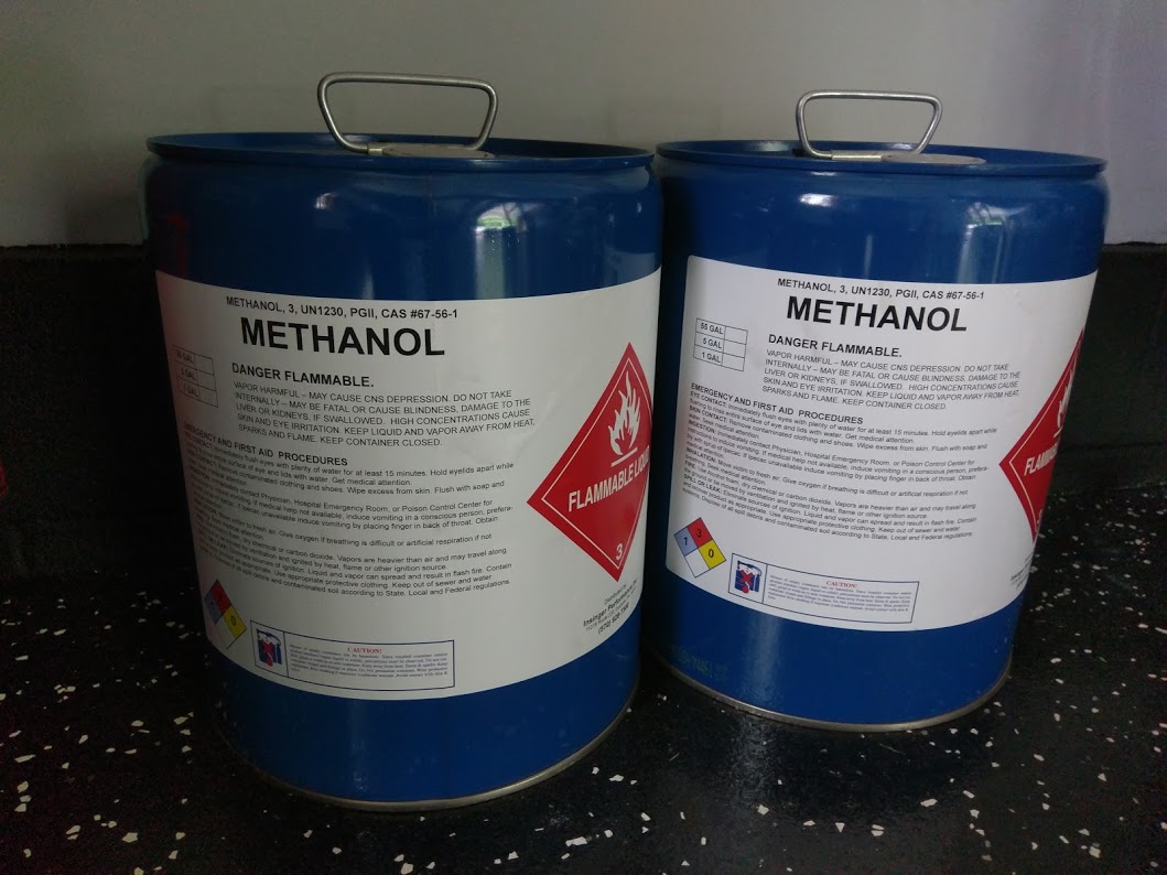

      I also read somewhere that you can run straight up distilled water, but not entirely too sure on that. The minimum I would personally run in a pinch would be BLUE windshield washer fluid which has somewhere around 25-30% alcohol. This is an option for me where I live because we are in the colder climates here in NJ. Depending on where you are, it may not be available. On the Snow website, they say you can even "spike" your blue washer fluid with 2-3 bottles of Heet(but that would be more expensive than just buying the Snow Boost Juice from Summit Racing). It really isn't priced that bad for a 49%-51% mixture of meth to water. I am lucky enough to have a local drag strip next to me so I went and bought the pure meth and mixed it myself - it's always fun to play Mr. Chemist lol. Just fired up my car a couple weeks ago for the first time so I am not at the point where I have even armed the meth system yet. Have another good month or so before my wheels show up. Car is rolling on 15" wheels now and the big brake calipers will not fit on there as long as I keep it rolling.
