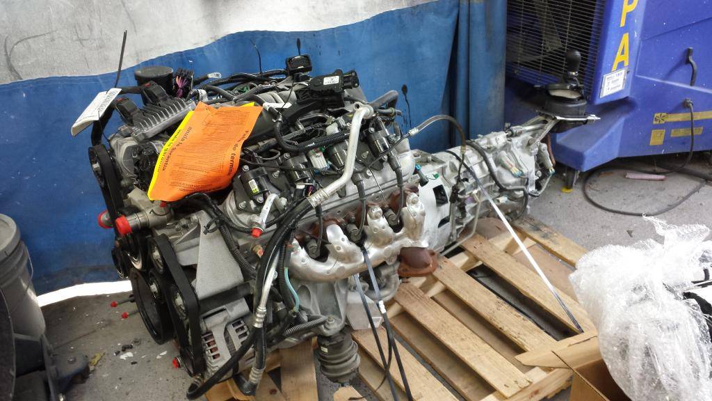

      I called a guy I know at LKQ used part/salvage yard in Denver and simply asked if he ever comes across any decently priced and low mile LS2's with T56's bolted to them. He said he could probably find something for me. Well, about two months later he calls me and says "Hey, I can't find any LS2's but I do have an LS3 with the TR6060 sitting on it in a wrecked 2013 Camaro SS with only 1,100 miles." Boom! Perfect. It was mine. I then advertised and sold the 383 stroker, 700r4, ignition system, fuel system, and all of the other accessories that were in the car as a turn-key package on Craigslist within a couple of weeks.
