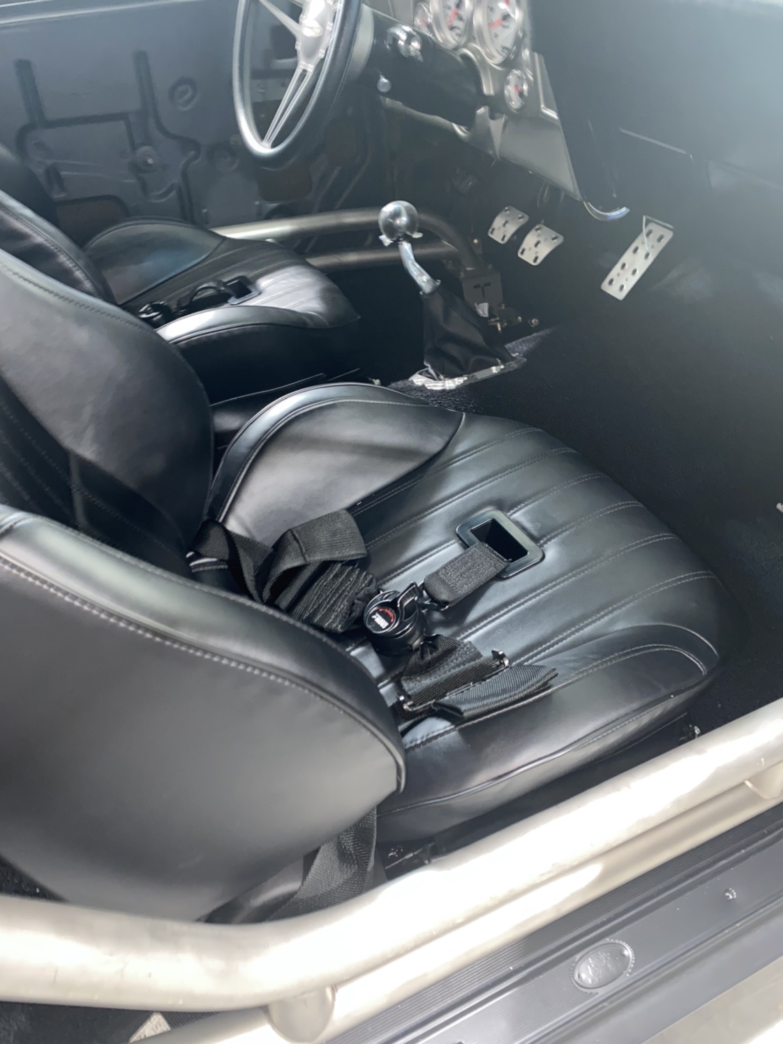

I was able to install these in my Nova for the tiger cage. Look under your seat to see if you can pass it through the seat frame. Only had to cut the seat foam out and did not have to modify the seat frame. Use a fabric pen to mark the top of the seat where you and it, then pass a screwdriver or something from the bottom to see if any of the seat frame will be in the way. Worked great on the Pro-Car Rally seats.

Attachment 187133
Attachment 187134

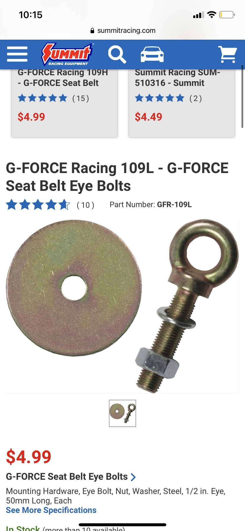

Here is the bracket I used. You could probably call and get one from ridetech or just use an I-hook and large washer. Here is the extra bracket that I used. Probably could just make your own if you wanted to.
Attachment 187141
