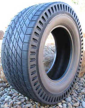

14" look best. If only you could find tires like we used to have.. 15" are the best looking. Those big wheels are out of scale on these older cars..
