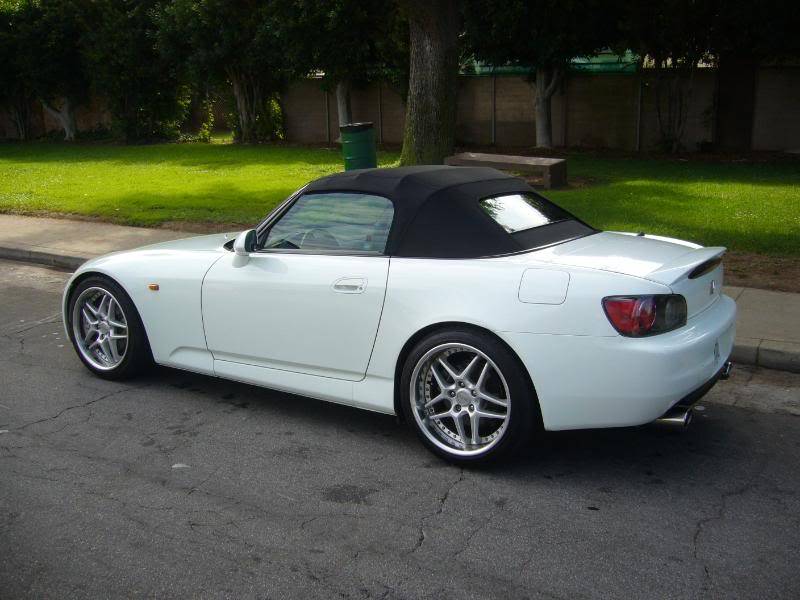

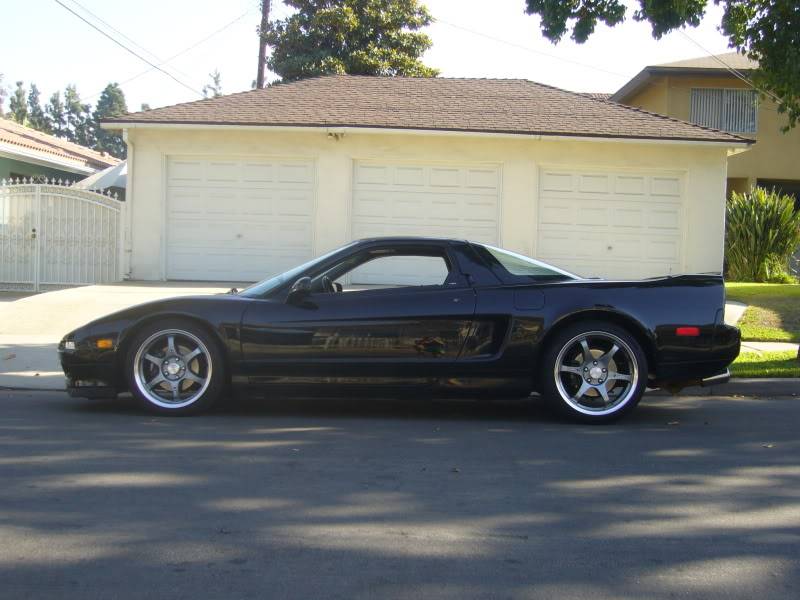

      Since you asked... Not sure if any of these would look good on the 66 Chevelle but since I have them already it's worth a test fit.
      Super lightweight on these...

      Nice collection you've got there.
      You are correct that it is very similar to running C5/C6 wheels, except that the wheels you have are actually medium offset versus high, not that it really matters. The fact that you're reducing your wheel pattern bolt circle diameter means that your stud loading is going to increase over what it is now, so an ARP upgrade would be wise IMHO, as well as a step up in size from 7/16-20 to M12x1.5 or 1/2-20 on the Chevelle. The center bore size difference should be an issue so long as the thickness of the adapters is sufficient to clear the snout of the hubs you are running.
      I don't know that I'd run four spacers that didn't cost at least $100 each, but I prefer to have torque rings and hub centric rings on my adapters. We made our own for our Nova project with C6 wheels and found that we can't make them to our standards for less than what other companies are selling them for...ouch. The quality of aftermarket adapters/spacers seems to vary widely in my experience though.

      Nice cars...those might look real nice on the 'Velle.

      I actually like both designs shown... first kind of reminds me of the split five spoke from Fikse.
      Run your adapters, keep your lugs torqued to spec, and enjoy them until you want to buy new ones.
