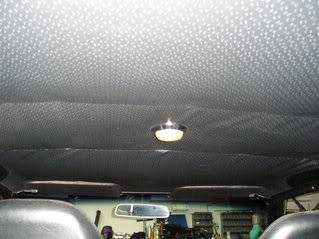

      I dont have pics of the installation, but I can get you a pic of the headliner installed. I would say the plastic headliner is BY FAR easier. With the hatch it basically slides right in and is held up by the dome light, sunvisors, and the front and rear headliner trim pieces.
      The bow kit took a good bit of time to install. The kit is basically 3 steel bows and the headliner material. The toughest part is getting the material tight and wrinkle free.
      The bow kit is by far cheaper, around $60 if I remember correctly. IMO the plastic when covered looks far better and makes the interior look a little more modern, and the added head room is a def a plus. As for selling my kit to you it may be quite awhile. It is far down the list as I have bigger plans in the works!

      Sorry it took me so long to get these up. Here are a few of the headliner (excuse the flash). Like I said if I were to do it over again I would use the hardboard headliner.
