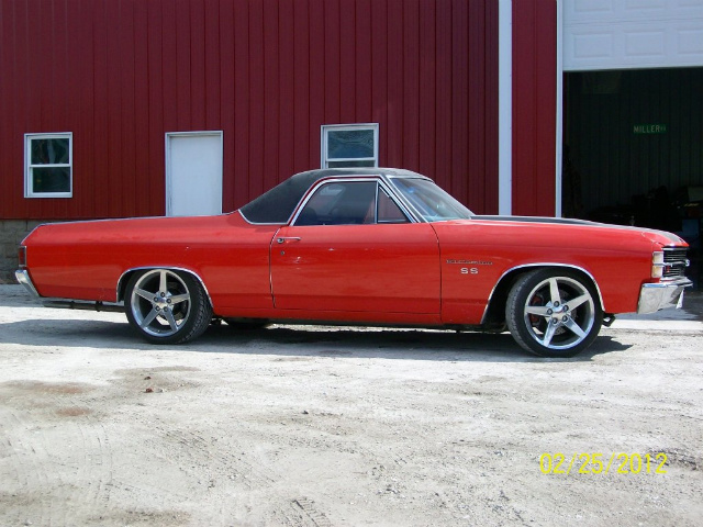

      I put C6 wheels on my 71 el camino I'm using 2 inch spacers in the front and 2.5 in the rear

      I've got over 4000 miles on this setup with no problems yet

      I had some c5 z06 replica wheels (18x9.5 and 18x10.5) on my 71 Chevelle. I used the same spacers as bmiller also. 2.5 on the front and 2 on the rear. I'm not sure if you would use the same or not on 64-67 abodies as the 68-72. I wouldn't worry about the wheel spacers as far as strength or reliability goes. Just get a billet spacer with hardened 1/2 inch studs and you will be fine. Also upgrade your current studs in your axles and hubs to larger and longer studs. You won't have any problems with the spacers if you do that and monitor wheel torque. The only thing I wouldn't do is go on a road course with them. Here is a pic of my 71 with the z06 wheels.

      Quote Originally Posted by Chevelle598bb View Post
      Damn that looks good what size brake you running?? After thinking about 18's and up I'm only running at 12" rotor and single piston Caliper you think it will look funny??
