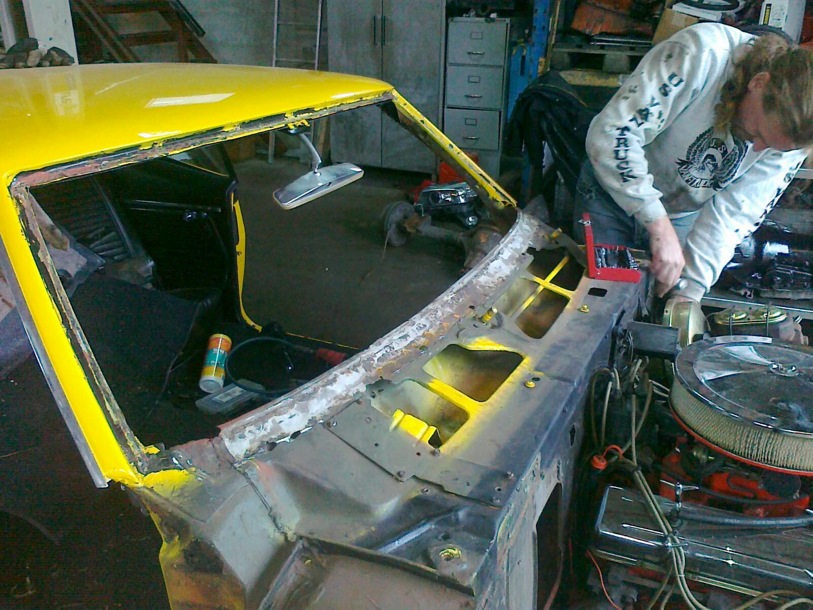

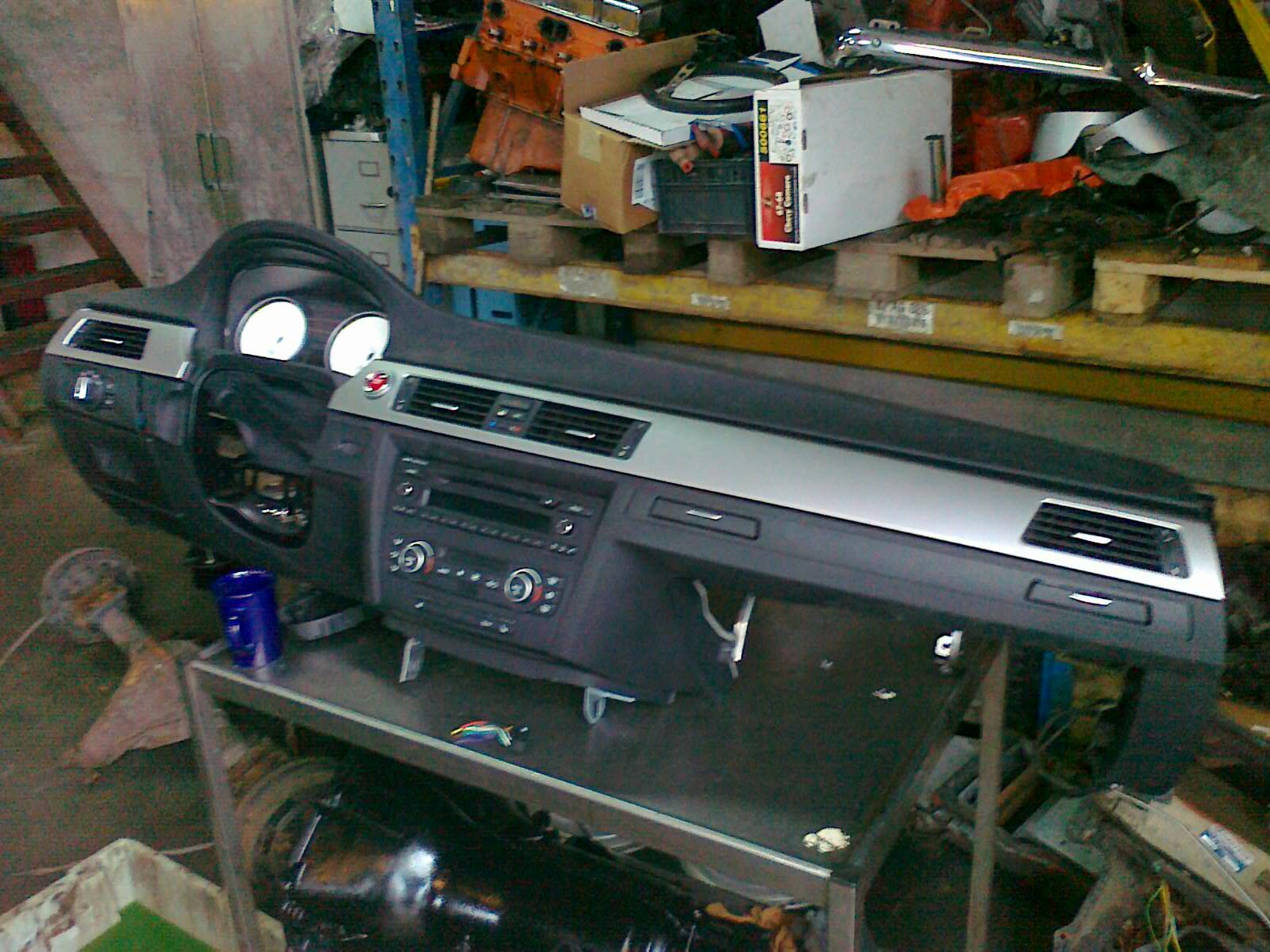

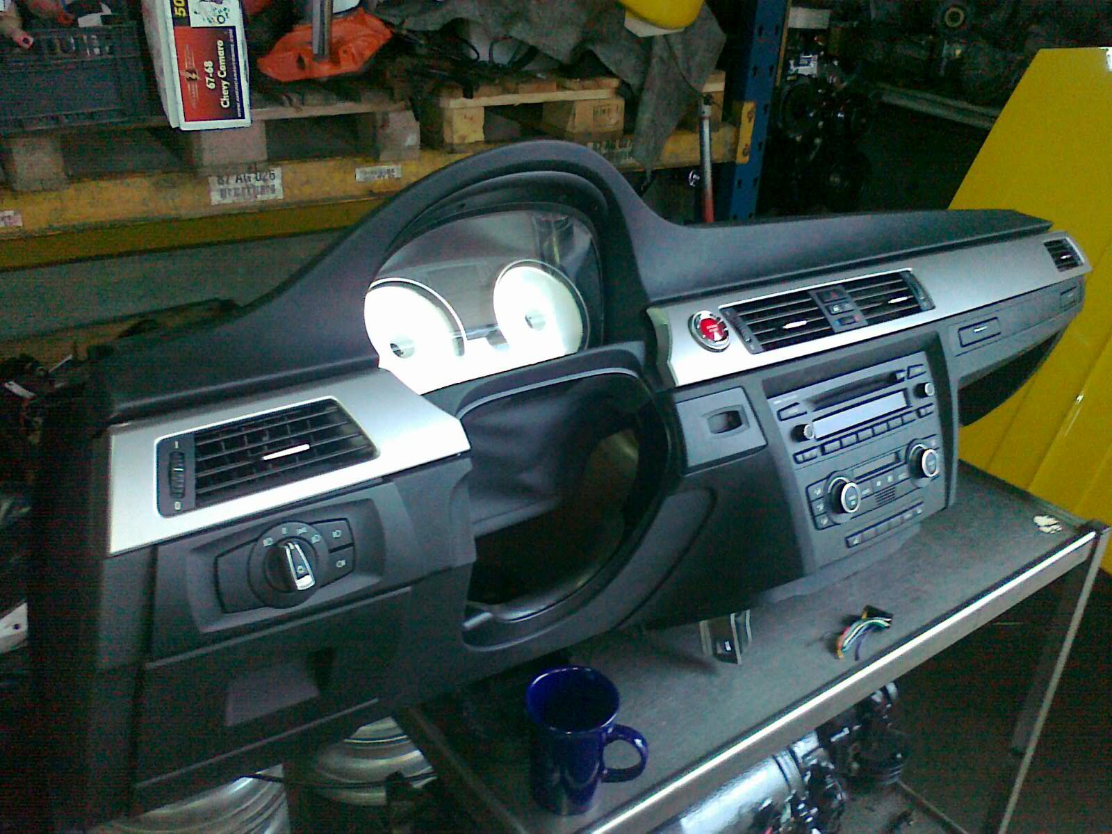

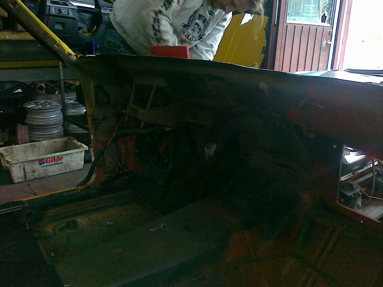

Hi guys! I saw there was another thread on here with a guy asking about a conversion like this. We`ve just started doing this on my 69 camaro, and it seems that the dash fits pretty well so far:-) A whole lot of work since we also found a lot of rust and bondo below the new top of the dash that at first sight looked really nice, but no....... The pics are in random order though....:-)

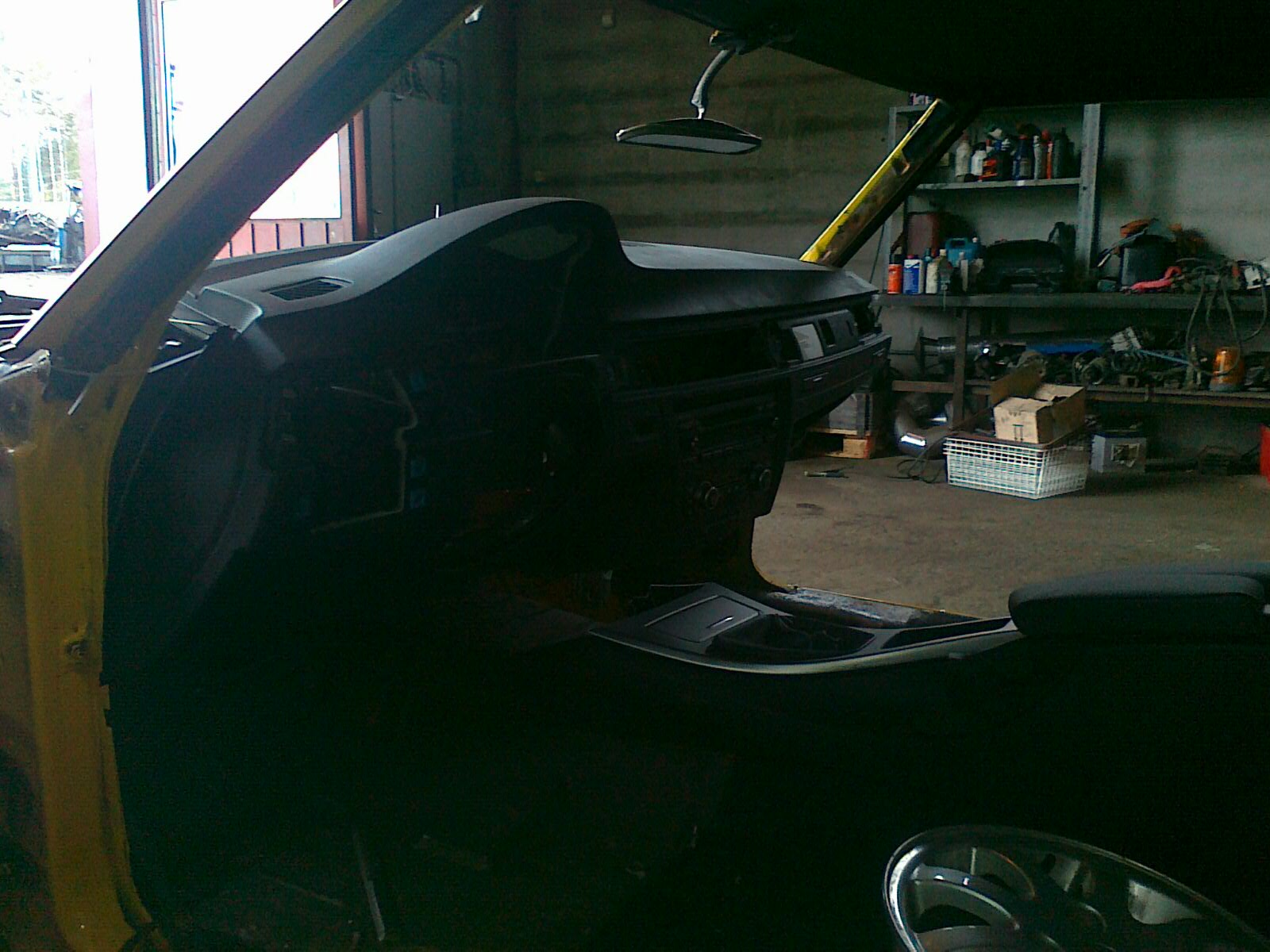

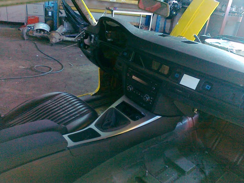

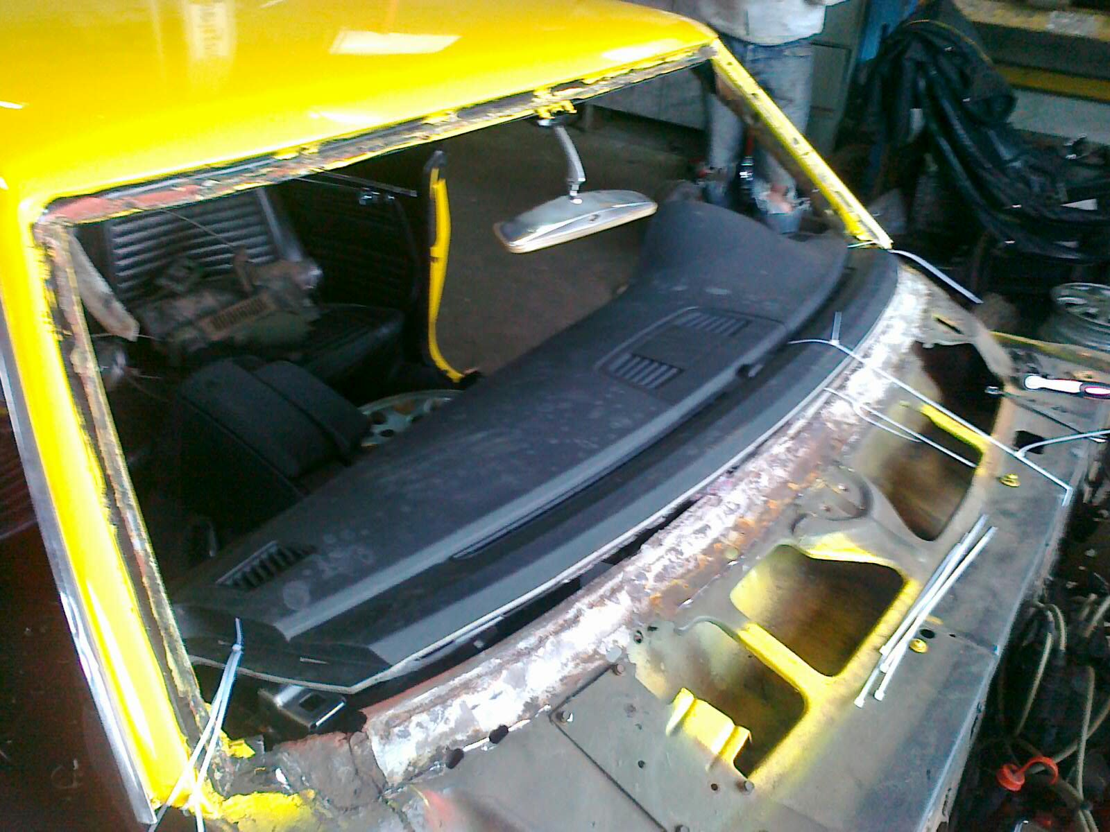

09-26-2011 #2Sorry about the poor quality photos, but my phone is not the best:-)

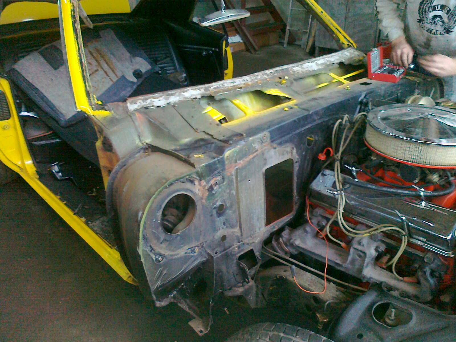

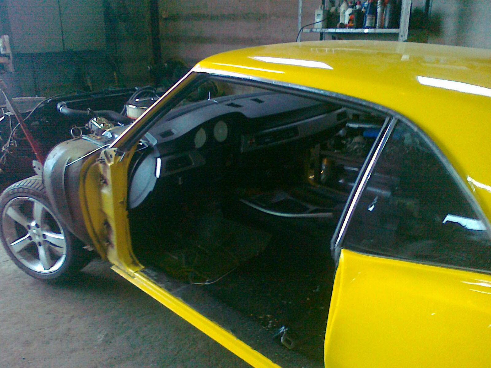

So far it seems that the outer edge of the dash needs to be trimmed an inch or so because otherwise the dash will sit to far against the driver. We will trim off an inch for starters tomorrow and see how it turns out. The sides fits pretty well- probably need to trim and recess the doors 1/2 inch or so to clear, but no big deal:-)Frank Jacobsen
