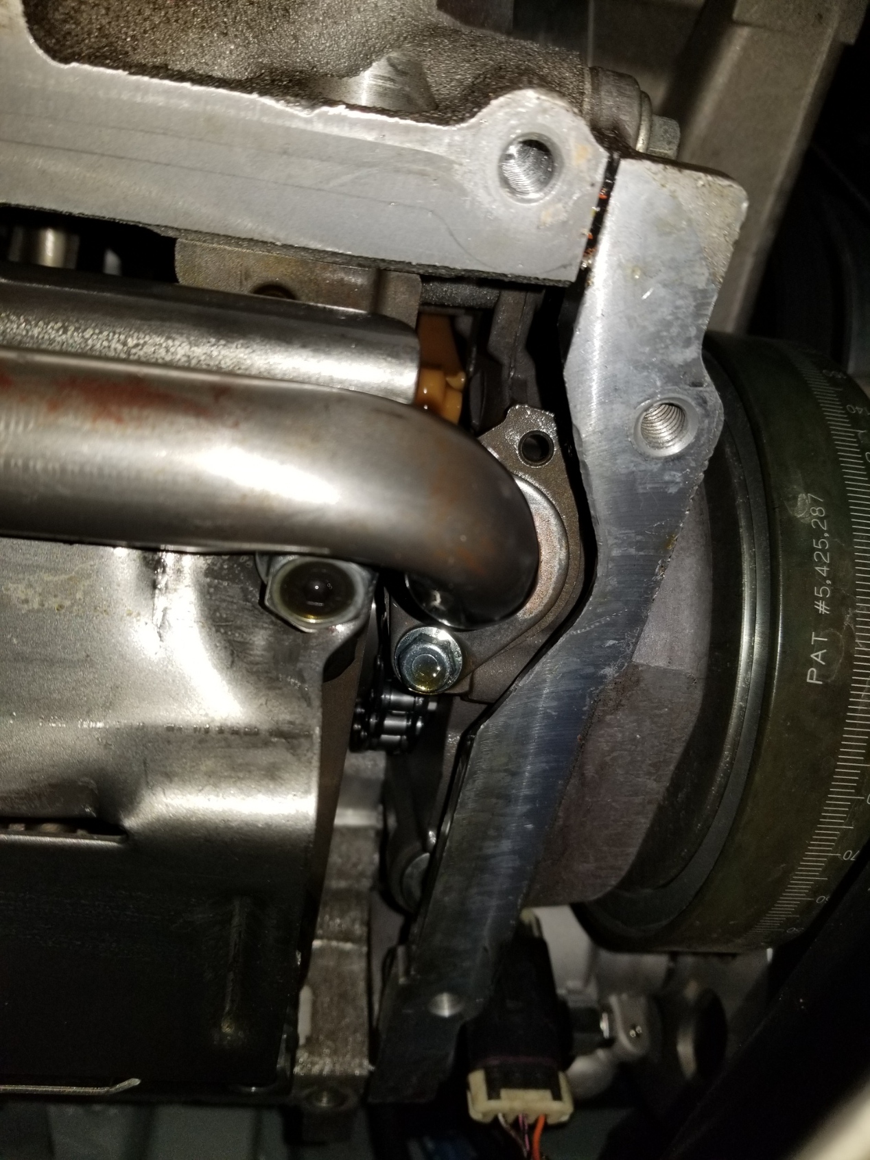

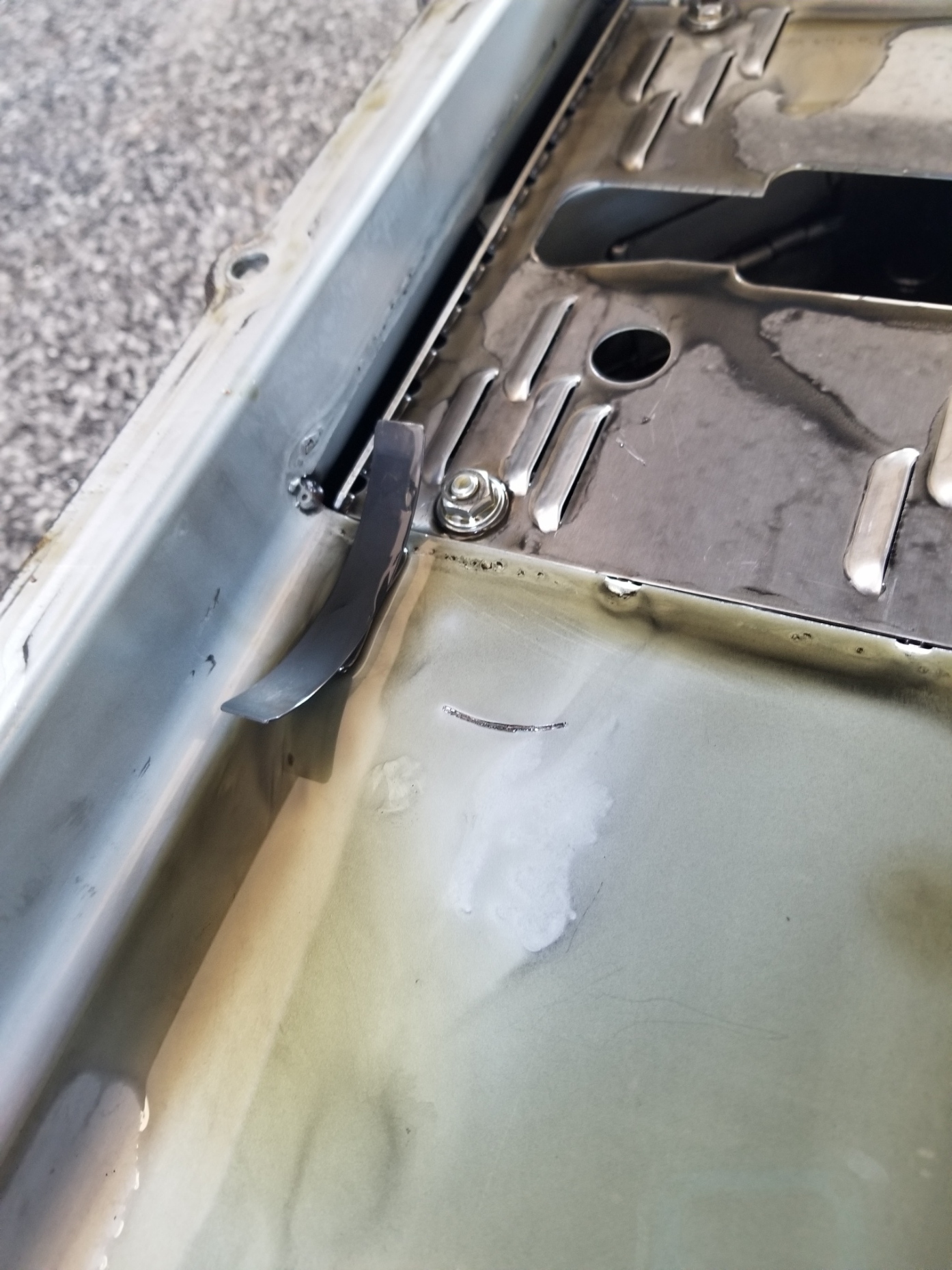

Just pulled the pan off my LS3 due to some suspicious oil and found this. Anyone know what it is? looks like it goes to the timing chain tensioner maybe.
Zach
2 Weeks Ago #2Looks like the spring is missing on the chain damper. guess that answers my question.
