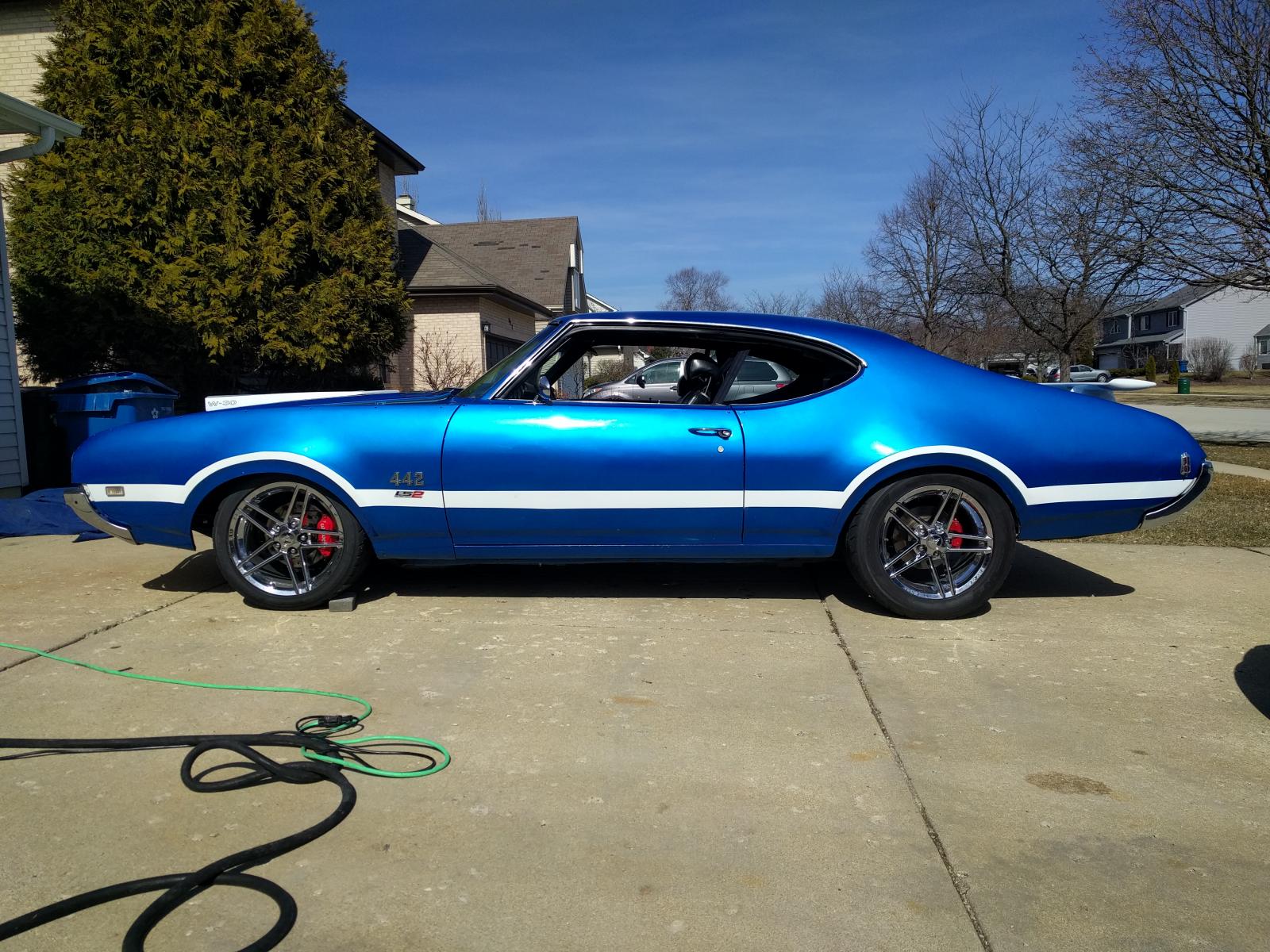

      Some people like to have the top of the wheel well just kiss the top of the rim. for the a lot of the 70+ A bodies, that can be achieved relatively easy. My personal taste is to leave some sidewall showing(try to get equal ratios front to back). On my '69, it's a pure radial arch, so I need a tall tire with sidewall to get the ratio and the body rake I desire. I think I did a pretty good job with it, it's not perfect but close I think. the front is a 285/35/R18 (25.91) and the back is a 295/45/R18(28.46). Spacing on the front needs to be dead nuts due to the width, I still kiss the inner frame with the tire on full lock.
      The dront is dropped ~3 inches(2'' from drop spindle, 1'' from Hotchkis spring") when I installed the tall lower ball joint, it was too much and I had to use a spring spacer to get back to 3''. The rear I think is dropped 2''. Hope this helps.

      Quote Originally Posted by jetmech442 View Post
      DOPE! What’s the width and backspacing for both the front and rear wheel? And just out of curiosity, do you think a 295 will fit on the front?
      Thanks for posting the picture, it looks really good
      The front is a 285/35/R18 (25.91) and the back is a 295/45/R18(28.46). Spacing on the front needs to be dead nuts due to the width, I still kiss the inner frame with the tire on full lock.
      Also interested in the width and offset on your front wheels. I'm seriously considering a 285/30/19 front tire, on either a 19x9 or 19x9.5 wheel, and am interested in your numbers, for comparison.

      Quote Originally Posted by USAZR1 View Post
      Quote Originally Posted by Yanchik
      Hey!
      I saw you put a picture comment on my thread with your Cutlass. Can you please tell me what width and backspace the front wheels are?
      And also, do you think that you could fit a 295 on front? Or is 285 the absolute max you would go
      Hey, so I'll give you all the math just so you can check it yourself also. I have 18x9.5'' C6 Z06 rims(front and back). They have a 7.38'' backspace, but I use a wheel adapter that is 1.37'' thick. So as far as backspacing, that puts me at 6.01''.
      Could I fit a 295? Sure. But at full lock I do kiss the inner frame. Not a huge deal because thats parking lot only type stuff. Currently, I don't rub at all on the outer fender.
      Let me know if you guys need any pics or measurements. I am considering adding a wee bit of thickness to the spacer to eliminate the frame rub, but am going to try a little at a time to make sure I don't ever hit the fender.
      Oh-also, if you have a big Hellwig bar up front, you need sway bar lockers(or maybe HD end links) that don't allow the bar to laterally shift, cause if you don't it will shift into your tire on slow parking lot type ramps. I just found this out the hard way two weeks ago. EDIT: Nevermind this, I spoke to mark and he thought that was weird behavior and suggested looking at the tierods to see if they were hitting the bar. He was right of course and I just raised the end link half an inch and the issue went away. Just thought I'd edit in case anyone re-read this.
      Last edited by jetmech442; 07-23-2018 at 01:50 PM. Reason: added comment for sway bar.
