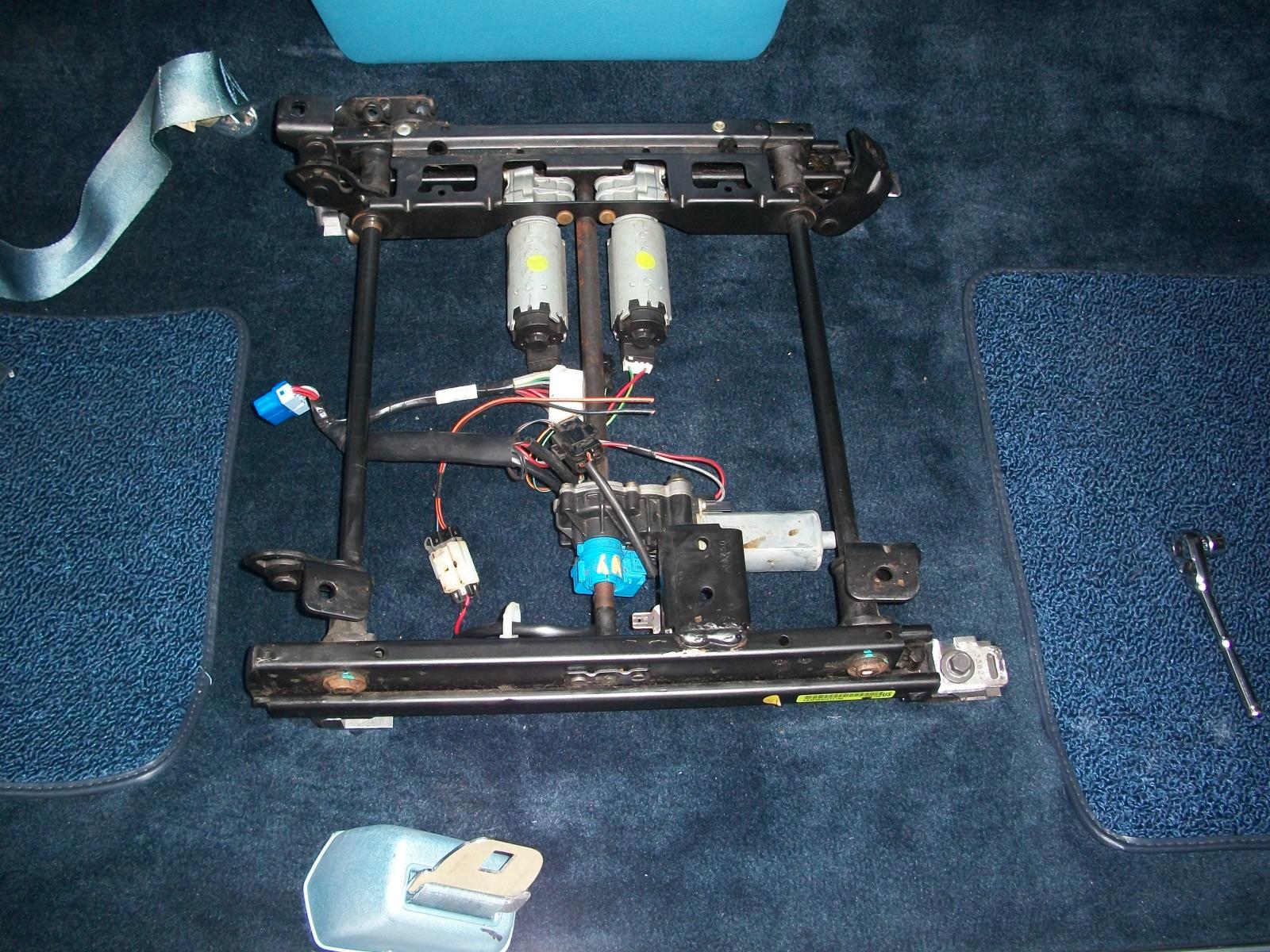

      Jan 2013
      Cypress, California
      381
      This is the only one I have and it is in the mock up stage. Flat stock was used for the front and welded to the seat rail. The rears were two piece with the top piece welded to the GTO seat rail and the bottom piece bolted to the floor with a slot for back and forth adjustment. Than a bolt through the back side to bolt the two pieces together. The object was to get the seat as low as possible so my head would not hit the headliner. That part worked out just fine as I have enough head room. I am 6' 1".
      Name:  GTO Power Front Seat ASSY.jpg
