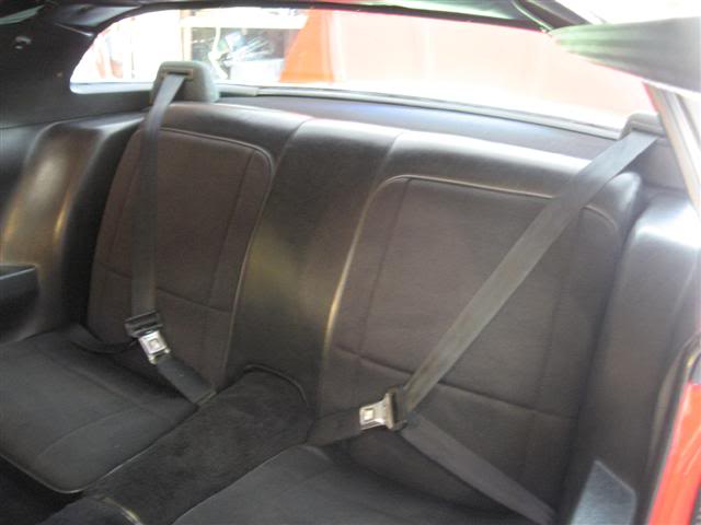

      Its hard to get around that and have properly installed belts. I used early 90s fox body belts that install on top of the package tray. If i were to do it today i'd by the morris belts.

      I would contact member CarlC about how he did his rear belts. I know he had put the retractors in the trunk and it looked like a really clean install.

      We now have the ratchet retractor for the rear to use with car seats.
      Yes our reels sit on the shelf panel with no worries of a frayed seat
      belt coming thru the rear shelf panel. There is a bracket that bolts
      under the shelf panel to the structure of the car.
      Thx, Billy
