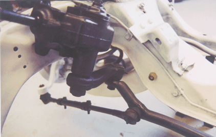

Once the car is securely on jack stands begin removing the old steering system. It is much easier to remove the system as a complete unit. There are two bolts attaching the rag joint to the steering column (remove these) and three for the steering box. Remove two of the steering box bolts but leave the last one in for later.

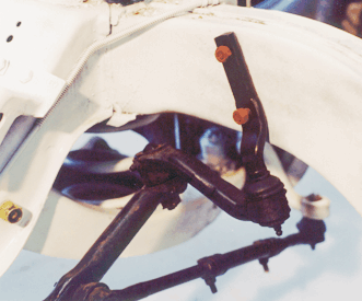

On the passenger side the idler arm is attached with two bolts, remove these now.

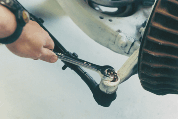

Both tie rods can be removed at this time. You may need a pickle fork to separate the rod end from the steering arm.
Now there is only one bolt holding the entire system in the car. If you are working underneath the car, make sure you support the steering box so it doesn’t land on your head. Remove the final bolt while supporting the box.
You can now pull the entire steering system out of the car. With only nine fasteners for the whole assembly, it takes 25 or 30 minutes to get to this stage.

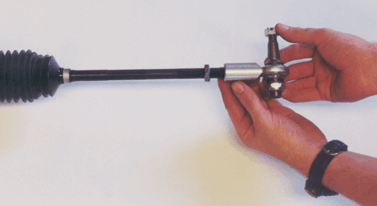

Thread the jam nuts and tie rods onto the rack and pinion unit. Be sure you thread an equal amount on both tie rods, this will insure the steering will be centered.
Measure the old steering and match the new to that dimension. This will get your alignment NEAR the ballpark. It is a good idea to measure the distance between the steering arms when the system is still on the car. Match that dimension when the new system is installed and you should have a pretty close toe alignment.

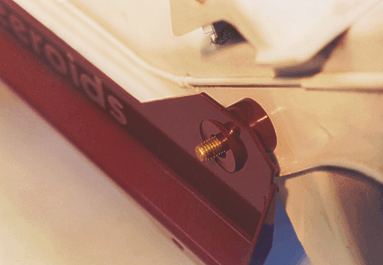

The stock a-arm bolts (two of them) must be replaced with longer bolts supplied in the kit.
IInstall the bolts in the aft, lower a-arm mount. You may need to grind a taper (like the factory bolts) to get them to go through.
The bracket must be installed one bolt at a time because they are angled. Push the bracket against the frame, the holes will line up so the other bolt will slide in.
Detail of lower a-arm attachment with bracket in place.
Washers are placed on the bracket side and the bolts are torqued to 80 Ft-Lbs. Elastic stop nuts are supplied. If these are removed more than twice, they must be replaced with new ones because they won’t hold anymore (the nylon has expanded too much).
