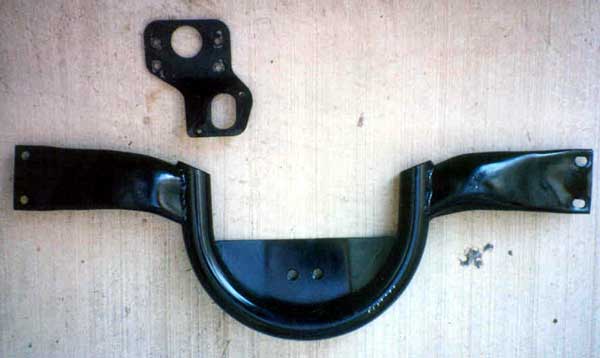

            The 1st gen F-body kit includes all of the “custom” components needed for a successful bolt in of any 93-97 T56 six speed transmission [pre LS1 engine] into any 67-69 F-body (or 68-72 Nova) with any small or big block Chevy engine. This includes a modified Turbo 400 cross member, adjustable length GM 96 Fbody hydraulic clutch actuator and slave assembly, and a firewall mounted bracket that adapts the hydraulics to the older car.
Click above for a larger picture
